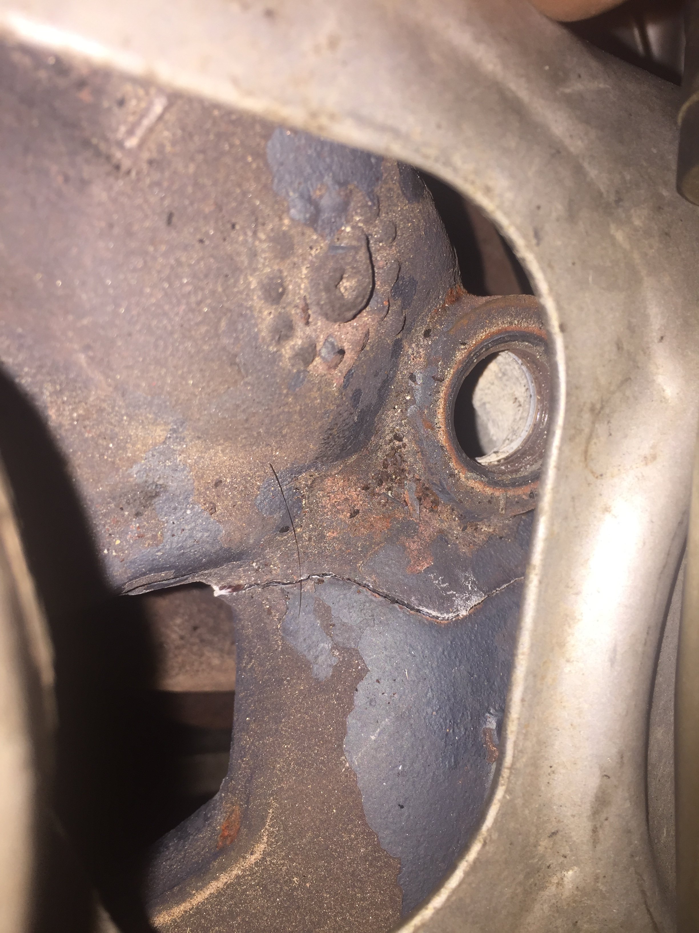

My 2014 has an exhaust smell in the cabin which is more noticeable when idling. I read online that the exhaust manifolds crack. Well today I’m getting into this and it’s a bitch. The secondary air injection is in the way on this model to access the exhaust manifold heat shield.
Finally got the heat shield of and can see a crack...

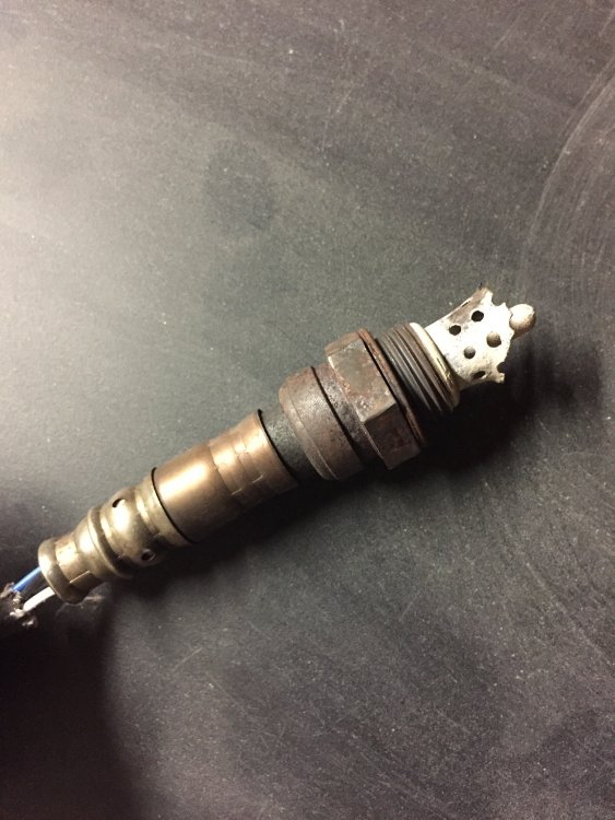

Now trying to remove and replace it. Got the O2 sensor out and it’s in bad shape!
