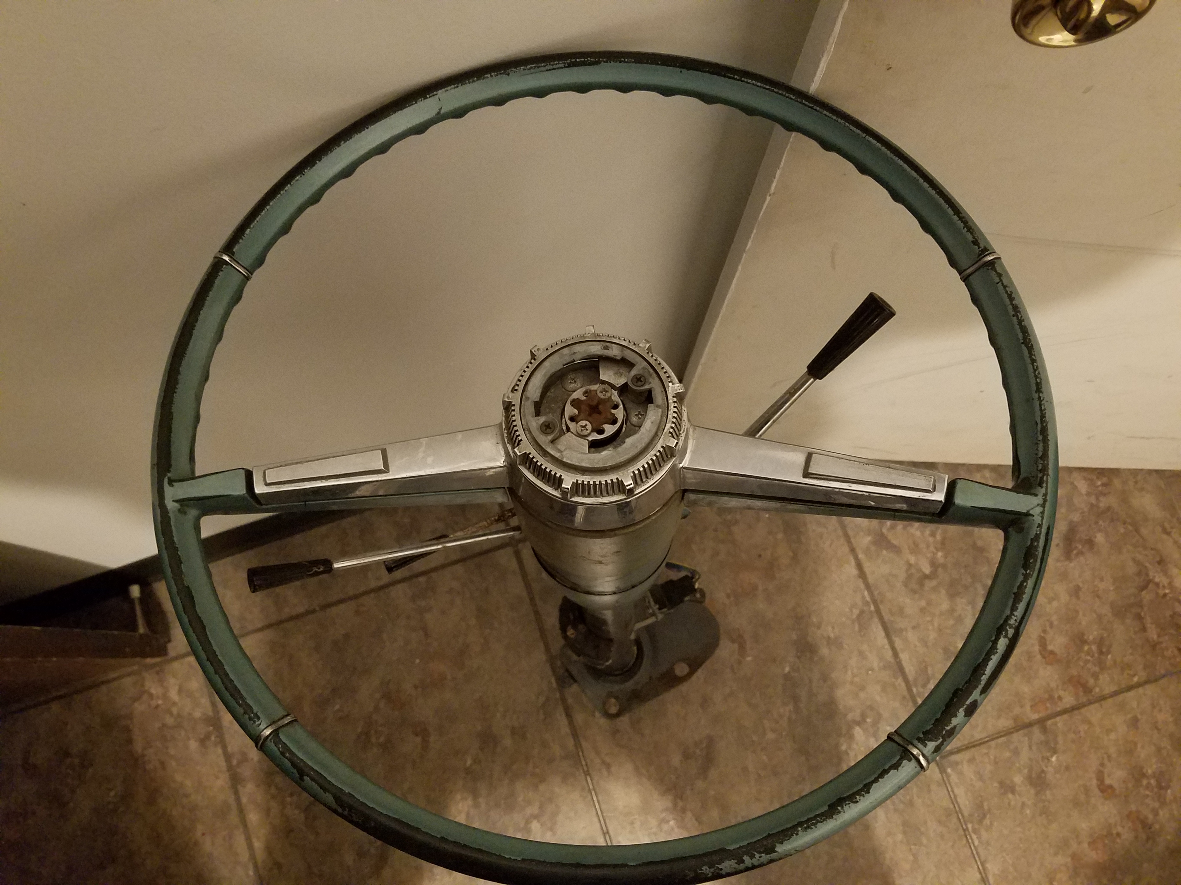

I have this tilt, automatic steering column with sectioned steering wheel. Can't find an exact match looking on google. Any ideas? Thanks
I did find out that it was a telescopic steering column. The guy turned the gear looking disc under where the horn button would go and it extended about 4-5 inches...
